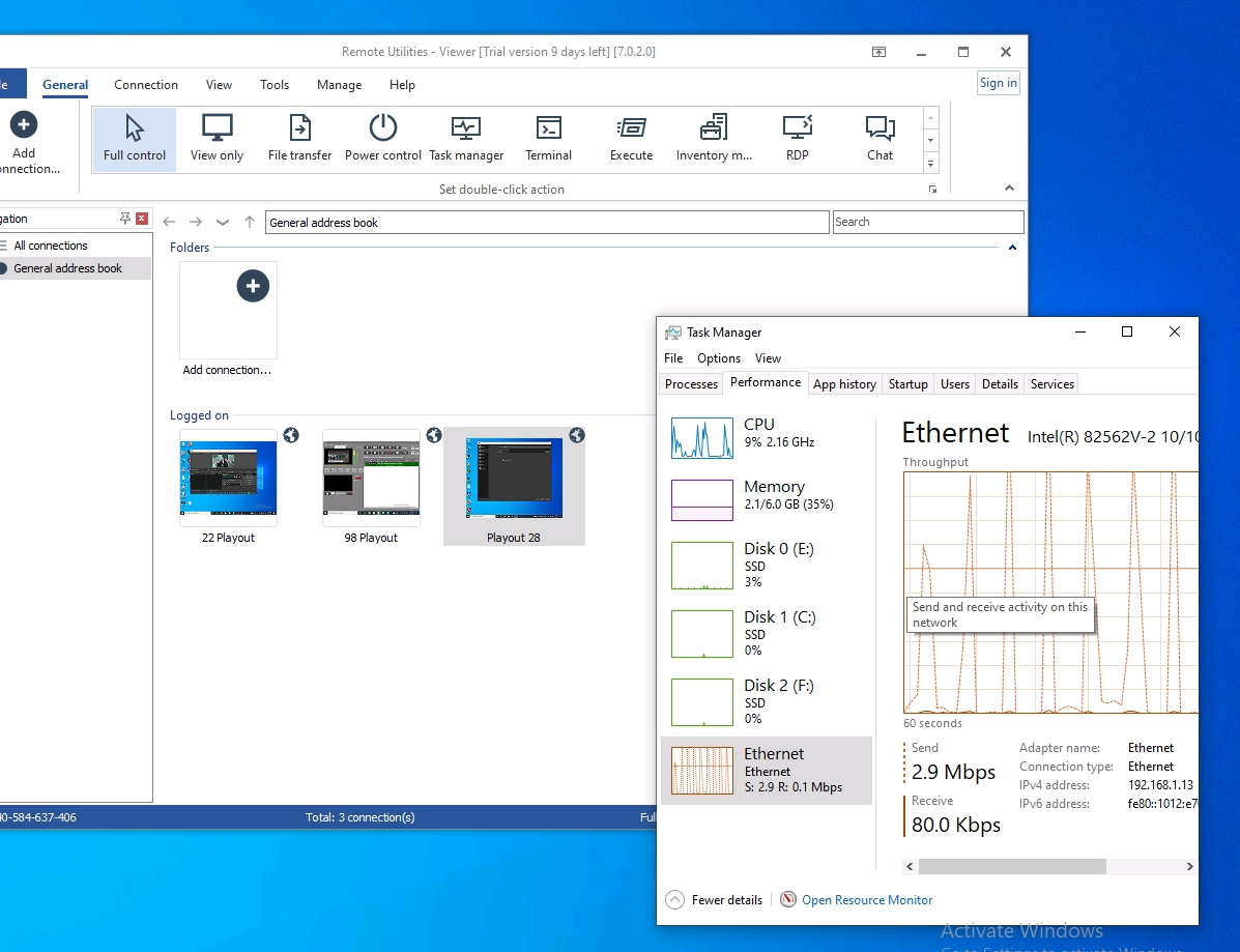

However,  Only the File Server, which I can operate remotely, can see all three of the streaming PCs.
#1 and 3 are "Viewable" from off site, but #2 shows offline from either anywhere but the file server
on the same switch.  Presently I am off site accessing the file server, and it is running well and CPU is lightly
loaded. My viewer shows #1 and #3 online, #2 offline.  The viewer on the File Server shows
all three on-line, and can connect to them, but performance is very very sluggish or the screens are not updating, as sometimes clicking off the current tab and back again updates the screen.  Also data entry in fields drops characters.
Task Manager can be launched on the file server and streamers and determine none are CPU bound.
The 100Mbps network activity is low, as can seen in the photo of the file server task manager.
If I directly connect from the web to server #1 and #3, which show online from across the web, performance is very good. Though sometimes the time to connect is excessive.

Web view performance to the file server has been poor, and at time thought on-line, I cannot connect
to it from the web showing "Connecting to File Server. Please wait..." for long periods of time if not infinitely.
#2 is offline- and this is the most concerning part of this, because inability to connect remotely is a show
stopper.  The curiosity is why the file server on the switch with the #2 streamer says its online, when the
world see it as offline.  The off-line status from the web can be seen in the attached screen shot "status
from the web:"

Douglas Crawford, User (Posts: 75)
Dec 03, 2021 4:42:03 pm EST
Addendum:  The 4 remote PCs are all running Windows 10 Pro.
The PCs have varying compute platforms.  The Problem #2 Streamer has a i5-2600.
The File Server is a Core 2 Duo as can be seen in the photo of its screen.
The Streamer #1 is a AMD A10, Streamer #3 is a i5-920.

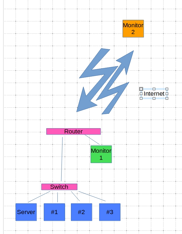

I'm going to make a drawing of the topology, as it is hard to form a picture in your mind
I think from my description.
One more time though- File Server, and #1, #2, & #3 play out computers are on one switch.
That switch is on a network with some other computers, one of which has viwers set up for all four of those
computers. Lets call this monitor 1.  I am off site across the internet lets call this monitor 2.
Dec 08, 2021 10:17:04 pm EST
Looks like the PDF didn't make it... here's a graphic.
