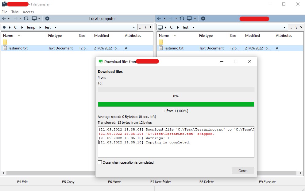

Hi,
I'm using viewer and host version 7.1.7.0.
I have a question regarding the "drag and drop" and "F6 Move" option in the "File Transfer" mode.
Is it on purpose, that the source file should be deleted even though you choose the skip option when doing a "F6 Move" to a location where the file already exists with same name and extension?
In the same scenario when doing a "drag and drop", the source file will not be deleted. But that's maybe because this action is considered as a copy and not a move?
The operations dialog box does say "Download files from" and "Move files from", but just wanted to hear from you if this behavior is on purpose :)

Hello Henrik,
Yes, the "drag and drop" is definitely considered as copying rather than moving a file. However, I've additionally forwarded your question to our development department and have asked for their input on this.

Hello Henrik,
I’ve checked on the issue with our developer and they’ve let me know that it’s not an expected or intentional behavior, so we will be testing this further in order to add a fix in our future updates.
