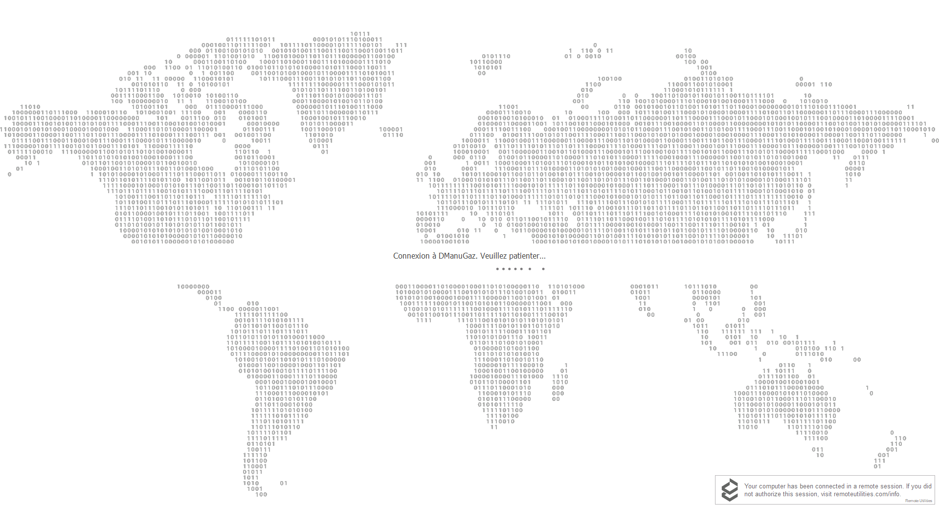

Hi,
When I tried to connect with the latest version of Remote Utilities, I have the following screen and I'm not able to connect.
Does anyone facing the same problem?
In this case, how do you solve it?

Hello Alain,
Unfortunately, this is a known issue - we've partially fixed it in version 7.0.0.3, but since it still manifests itself in some scenarios, we'll be adding additional fixes for this issue - the fix will be available in our next update. We'll do our best to release an updated version as soon as possible, but, unfortunately, we cannot provide any specific ETA on this update yet. Sorry for the inconvenience.
Meanwhile, please try the following temporary workarounds that might help connecting to a remote Host:
1. Authenticate/Log in on one of your Hosts where the issue with the "world map" window occurs.
2. Start a Full Control session. The "world map" screen must be showing for some time.
3. In the Full Control window, right-click on the connection tab, select Send key command and choose a command to send (e.g. the Alt+PrtScr command or you can choose any other).
4. If everything goes well the connection should immediately be established.
If the above solution did not help, please try simply closing the Full Control connection window and re-opening it once again right away.

Hi,
I'm trying from 2 different computers to connect on a Remote utility Host in v7.1.5.0, on the first one, it's immediate, on the second one, I have the screen attached.

Hello Alain,
Please try enabling the Use legacy capture mode feature in the Host Settings -> Other tab for the Host machine where the issue occurs and see if this helps.
Please make sure to restart Host after enabling the feature in order to apply the changes.
