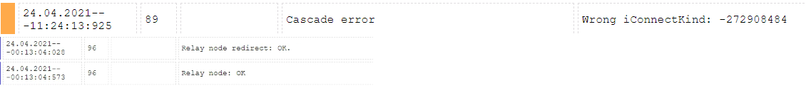

When I try to apply the "Blank host screen" setting, the host log shows that there is cascade error - Wrong iconnectkind - 272908484. May I know what is the error?
May I also check with you what is relay node redirect?
Thank you.

Wrong iconnectkind - 272908484 error entry means that something is modifying the traffic from time to time - for example, it might be your router or some kind of privacy software.
As for the "relay node redirect" entry - I will also check on this with our developers and will get back to you with their reply.
