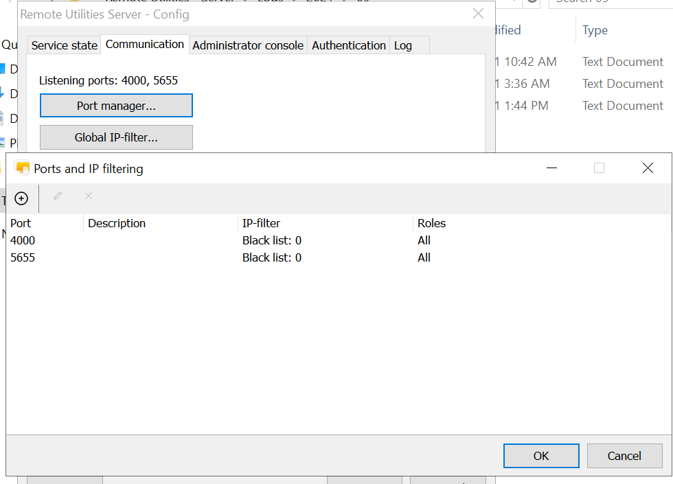

Changing the default port.
Алексей Семенов, User (Posts: 6)
Sep 29, 2021 5:24:42 pm EDT
and if you restart the server without closing the config, it will reset everything to the previous values.
Sep 29, 2021 5:22:46 pm EDT
the question is removed.
I found out what the problem was.
If you do not close the config, it does not update the parameters.
And restarting from the config does not update these parameters either.
It was necessary to make changes, completely close the config console. and restart the server.
I feel stupid)
Sep 29, 2021 4:56:46 pm EDT
I sent the logs.They are almost empty. but after looking at the logs.
I saw that when restarting the server, it does not listen to other ports.
although the port is specified - 29 Sep 2021 04:59:01
13-44-17 29-09-2021 T: Server starting. Version: 3.0.1.0 (3010)
13-44-17 29-09-2021 T: Listen 5655 port.
13-44-17 29-09-2021 T: Server started.
Edited:Алексей Семенов - Sep 29, 2021 4:59:06 pm EDT
Sep 29, 2021 2:30:21 pm EDT
restarted it. it didn't help.
Sep 29, 2021 2:33:48 am EDT
the server and the host are on the same LAN. 5655 and 4000 port are not visible from the outside.
5655 works, but 4000 does not. (any other port other than 5655 is not seen by the host)
on the server firewall, all ports of the mini-server are open.
Sep 28, 2021 10:13:01 am EDT
Hello.
If I change or add another port other than 5655.
The host stops seeing the mini-server.
In the firewall, the port is any.
What is the reason?
host v7.0.2.0
server v3.0.1.0
