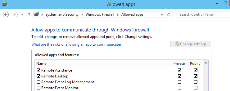

Issue with RDP from offsite
Still looks like a firewall issue. If your Windows Firewall is enabled on the remote PC, please make sure that the public checkbox is selected for "Remote Desktop" in the exclusion list. See the screenshot below.
 - Tue, 06 Jan 2015 23:13:23 GMT
I'm assuming that you are connecting over the Internet using the Internet ID as a "tunnel" for the RDP connection (the so called RDP over ID feature).
